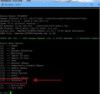

Hi,How do I uninstall Skynet and Wireguard in AMTM?
I see no option to uninstall in the menu.
Thanks.
if it's wireguard manager press 2
Solved - How do I remove WG Manager from amtm without resetting amtm?
How do I remove WG Manager from amtm without resetting amtm? Amtm shows it as installed it’s not.www.snbforums.com
Lol, thanks for that, to be fair to the OP, that option doesn't really leap out at you though.
If it's a legacy thing where folks had it installed / thought it was installed but it is still showing up in amtm, I can understanmd it, but if it's just a menu (or out of sight) option maybe @Martinski or @ZebMcKayhan could update the menu options so it is a wee bit clearer?
I plugged in the USB again and tried to access Skynet by pressing 2, but I get...
The USB thumb drive is connected and I can see in the Router GUI. Is there another way to uninstall Skynet?
/usr/sbin/curl -s "https://raw.githubusercontent.com/Adamm00/IPSet_ASUS/master/firewall.sh" -o "/jffs/scripts/firewall" && chmod 755 /jffs/scripts/firewall && sh /jffs/scripts/firewall install
