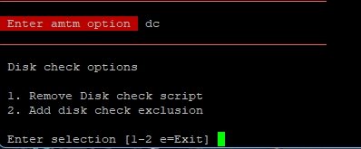

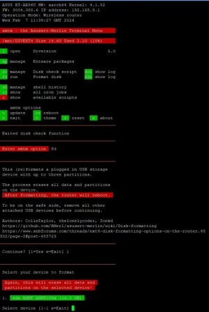

That's great to hear.
I asked as whilst I found the DC uninstall one, I struggled with the FD one, and I didn't want to format anything to go deeper in that menu.
I looked at https://github.com/RMerl/asuswrt-merlin.ng/wiki/Disk-formatting and I looked at https://www.snbforums.com/threads/e...ptions-on-the-router.48302/page-2#post-455723 which was referred to by that script (searched on uninstall) but it do not leap out at me (and I still cannot see it).
I looked at https://github.com/RMerl/asuswrt-merlin.ng/wiki/Disk-formatting and I looked at https://www.snbforums.com/threads/e...ptions-on-the-router.48302/page-2#post-455723 which was referred to by that script (searched on uninstall) but it do not leap out at me.

fd format disk is the simplest of all to uninstall: It removes itself after formatting is done or when openend and not used. As with all options in amtm, there will be questions asked before installing. fd asks a bunch of questions before formatting is done.
amtm is safe to use, I don’t trick anybody into doing something stupid ;)
