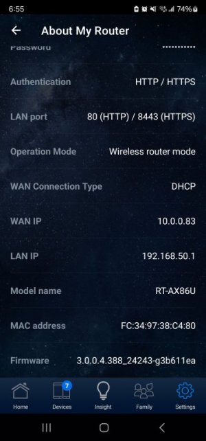

My firmware for my router is: 3.0.0.4.388_24243. Both extenders are: 3.0.0.4.386_51891-g12b4ca4
On the Asus app it has:
