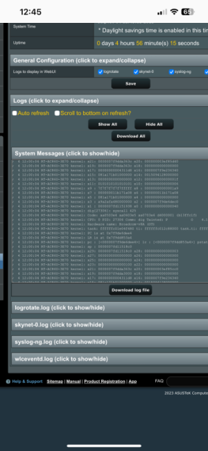

I don’t know why my syslog is jam packed with these kernel messages. I don’t know what is going on or how to remove them.
The router is working fine and doesn’t seem to be a problem, however I’m not sure if it’s something I should be concerned about.

12:00:04 RT-AC86U-3E70 kernel: x17: 00000000004311d8 x16: 0000007f9e236340
Nov 4 12:00:04 RT-AC86U-3E70 kernel: x15: 081a171b01000000 x14: 0015094128000000
Nov 4 12:00:04 RT-AC86U-3E70 kernel: x13: 0000000000000000 x12: 000000000000001f
Nov 4 12:00:04 RT-AC86U-3E70 kernel: x11: 0101010101010101 x10: 0000000000000006
Nov 4 12:00:04 RT-AC86U-3E70 kernel: x9 : 7f7f7f7f7f7fffff x8 : 00000000000001a9
Nov 4 12:00:04 RT-AC86U-3E70 kernel: x7 : 000000011b171a08 x6 : 000000011b171a08
Nov 4 12:00:04 RT-AC86U-3E70 kernel: x5 : 081a171b01000000 x4 : 0000000000000000
Nov 4 12:00:04 RT-AC86U-3E70 kernel: x3 : a9a2afa480000000 x2 : 0000007f9de6dec0
Nov 4 12:00:04 RT-AC86U-3E70 kernel: x1 : 0000007fd1151938 x0 : 0000000000000040
Nov 4 12:00:04 RT-AC86U-3E70 kernel: dig[27306]: syscall 425
Nov 4 12:00:04 RT-AC86U-3E70 kernel: Code: aa0503e4 aa0603e5 aa0703e6 d4000001 (b13ffc1f)
Nov 4 12:00:04 RT-AC86U-3E70 kernel: CPU: 0 PID: 27306 Comm: dig Tainted: P O 4.1.27 #2
Nov 4 12:00:04 RT-AC86U-3E70 kernel: Hardware name: Broadcom-v8A (DT)
Nov 4 12:00:04 RT-AC86U-3E70 kernel: task: ffffffc01e04f480 ti: ffffffc012c88000 task.ti: ffffffc012c88000
Nov 4 12:00:04 RT-AC86U-3E70 kernel: PC is at 0x7f9de6dee4
Nov 4 12:00:04 RT-AC86U-3E70 kernel: LR is at 0x7f9dd853a4
Nov 4 12:00:04 RT-AC86U-3E70 kernel: pc : [<0000007f9de6dee4>] lr : [<0000007f9dd853a4>] pstate: 20000000
Nov 4 12:00:04 RT-AC86U-3E70 kernel: sp : 0000007fd11518c0
Nov 4 12:00:04 RT-AC86U-3E70 kernel: x29: 0000007fd11518c0 x28: 0000000000000003
Nov 4 12:00:04 RT-AC86U-3E70 kernel: x27: 0000000000000000 x26: 0000000000000000
Nov 4 12:00:04 RT-AC86U-3E70 kernel: x25: 0000000000000000 x24: 0000000000000000
Nov 4 12:00:04 RT-AC86U-3E70 kernel: x23: 0000000000000100 x22: 0000000000000000
Nov 4 12:00:04 RT-AC86U-3E70 kernel: x21: 0000007f9dda363c x20: 000000003ef85cc0
Nov 4 12:00:04 RT-AC86U-3E70 kernel: x19: 0000007f9dda3000 x18: 0000000000000000
Nov 4 12:00:04 RT-AC86U-3E70 kernel: x17: 00000000004311d8 x16: 0000007f9e236340

Do you have entware installed with dig installed?
I have Entware installed but I haven’t installed Dig. I have Diversion, Scribe, ScMerlin and Skynet installed and I’m currently on the latest version of RMerlins firmware for my router.
Is this a Dig problem? If so could you please let me know how to go about fixing it?
Thank You
There is a problem with dig, which is used by one or more of your addon scripts. Try updating Entware.

Hello, I tried running those two commands but the Dig is still showing Kernel errors. I changed USB sticks and reformatted JFFS and the USB Drive, then resonated all the same scripts I had before but I’m still getting those pesky spam messages about Dig and the Kernel.
Would doing a full reset of my router and reformatting my USB stick again after resetting the router help out any you think?
I guess it’s not a big deal because everything still runs fine as far as I know. It’s just the pages and pages of Dig Kernel spam that gets to me.
If you think I should just leave well enough alone I will. If you have any more tips I would appreciate it greatly.

Same problem has been reported in other threads. It was a bug in Entware. See this post and the following one:
So based on that try this:
opkg update
opkg remove --force-depends bind-dig
opkg install bind-dig
opkg remove --force-depends bind-libs
opkg install bind-libs
opkg remove --force-depends libuv
opkg install libuv
But if you had wiped your USB drive and reinstalled Entware the commands above ought not to be necessary. :confused:
After some digging ;) I had them again after an clean install. I deleted uiDivStats and rebooted. Clean logs.
After some digging ;) I had them again after a clean install. I deleted uiDivStats and rebooted. Clean logs.
Thank You, uninstalling uiDivStats and a reboot did the trick for me as well. No more spammed Kernel Dig messages.
Thanks to everyone who made suggestions to me, I really appreciate it!

Just found that dig was broked on my 388.7 install, found this post and fixed instantly. Thanks.
