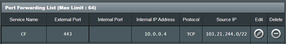

to fix this I am trying to add whitelist those IP Ranges | Cloudflare Cloudflare IPs in CIDR format to point to my webserver, but I got this error

I already enabled port forwarding for those Cloudflare IPs, but still having this 522 error sometime, not always.

As @eibgrad said, you need to specify the source on the Virtual Server / Port Forwarding page. If you've already done this then there's nothing else to do as the firewall will already be dropping packets from other sources.
But my guess is that this is an issue with your server rather than the router. You can check that Enable DoS protection is disabled on the Firewall > General page and see if that makes a difference.

What rule have you setup to allow it? Did you setup a Port Forward like in Colin’s screenshot?
yes, nothing in NSF I cleared everything
