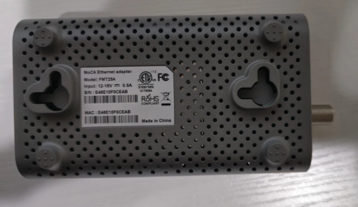

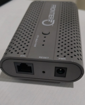

Frontier FMT25A product images:

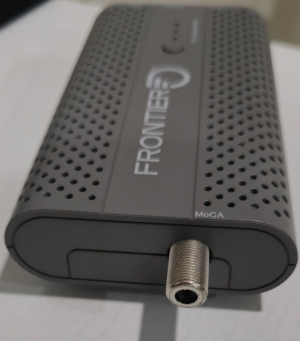

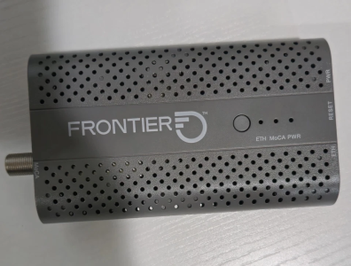

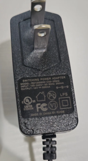

Additional images from the auction page...
