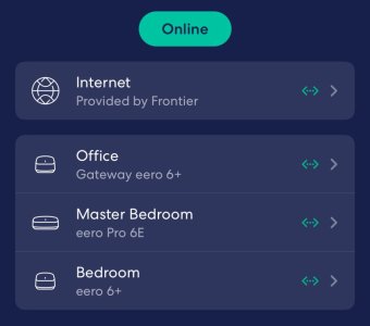

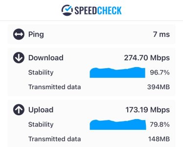

Thanks for all your help! Got everything hooked up based on your diagram and all my Eeros are wired now via MoCA.
Couldn’t have done it without your help! Really appreciate it.
