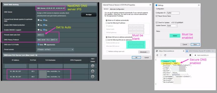

This question I have is regarding the NextDNS installer itself.
This sub forum: https://www.snbforums.com/threads/nextdns-installer.61002/ seems to be inactive for over 2 years.
and I can't post anything there.
Hopefully, someone can help me out as to what NextDNS installer actually do.
From my finding when you have NextDNS installer (Windows client) installed on the PC and it is enabled.
DOH or Secure DNS is working - test on the web browser on the same PC -test.nextdns.io
Otherwise, if the software is disabled (stopped) then DOT will used.
However, when the NextDNS client software is disabled/stopped. Protocol is now changed to DOT.
So my question what does NextDNS installer/client actually do?

It's mainly useful if you have multiple NextDNS profiles, as each device on your network can easily be assigned a different profile (if so desired). It's also configured out of the box to send responses with low TTL values to clients, so the clients will constantly ask the router about DNS information. This is done so changes made to your lists of your NextDNS profiles get seen very quickly by your router devices. Useful for promptly hunting down and fixing incorrectly blocked domains.
If you don't care about individual device domain logging, multiple blocking profiles or quickly fixing false positives, you can stick with the built-in DoT solution in the Merlin firmware and just apply a single NextDNS profile to the entire network.

The NextDNS CLI solution's DoH will override the built-in's DoT solution. So you wouldn't be using both at the same time. But yes, you can technically set up one NextDNS profile for DoH and then when the CLI is disabled, you can fall back to another NextDNS profile using DoT.
You technically don't need to mess with CAs. Installing the NextDNS CA is mainly useful for having their custom block page show up on devices when you visit a domain being blocked. It's not a necessity to install it though.
Also, note that their installer for Windows is not the same as the CLI for Merlin. You don't need the installer for Windows if you run the CLI on the router. That's the point.
