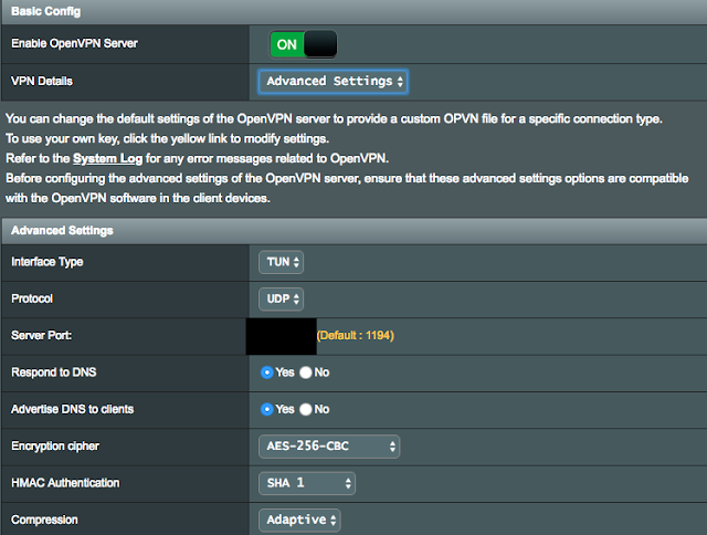

Hi folks,
I'm very new to OpenVPN and am looking to get it a private VPN server setup on my ASUS DSL-AC68R router. I am strictly following this guide so the settings in the ASUS router are exactly the same as shown below: https://randyshomeprojects.blogspot.com/2016/11/openvpn-on-asus-router.html
I setup the server and export the config file to my Android. I press the toggle button to connect and then I am prompted with
Select Certificate. This profile doesn't include a client certificate. Continue connecting without a certificate or select one from the Android keychain?
I press continue and bypass the 'no certificate' prompt and it connects with no problems. The VPN connection is successful and all is running fine.
To see if it isn't just an Android issue I try to connect to the server on a laptop and then get a similar error
Connection Error. Missing external certificate

There is a certificate section in the config file as shown above so I am bit confused as to why it is saying there is no certificate as I thought when exporting that client.opvn file, everything should all be in there including the certificates to make a secure connection. I thought it was as simple as exporting the client.opvn file from the ASUS server to the client device and connecting. Although I can get away without using a certificate and successfully making a VPN connection with the server, ideally I want my VPN connection to be as secure as possible so I was wondering how I can go about implementing this certificate properly? I understand from research that one can simply add the line "--verify-client-cert none" to the server config file but that completely avoids the issue and compromises the security of the connection? I have also performed a factory hard reset to no avail.​
Thanks in advance!
Technically, you don't need to use client-based certs/keys. But yes, doing so increases security. I don't use the OEM firmware, so I can't speak directly to what its OpenVPN server GUI offers. Sometimes the GUI has the ability to auto-generate such certs/keys, but it *may* be the case that the stock firmware is limited to simple username/password, and only auto-generates the CA cert. And if that's the case, you may be forced to generate these yourself, outside the router, e.g., from a Windows or Linux PC using EASY-RSA. Then either use the appropriate fields in the GUI (if they are available), or worst case, specify the additional certs/keys *inline* using the custom config field.
Again, since I don't use the OEM firmware, I don't know how flexible it is. I'm making an educated guess as to how it works. That's why so many ppl embrace Merlin's firmware. It makes a lot of this stuff trivial by offering a more thorough and richer environment. But of course, that assumes YOUR router is supported.
P.S. If it's any consolation, many commerical OpenVPN providers don't offer client-based certs/keys either! Just simple username/password w/ a CA cert (to authenticate the client and server). As I said, this is minimally sufficient. But I too prefer to authenticate individual clients w/ their own cert/keys. I just don't want you to be under the false impression that simple username/password is easily compromised. It's NOT.

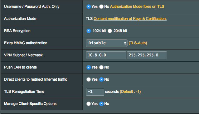

Nervermind, I think I solved it!
I simply changed the first setting in the image above to 'No' and that changed the authorisation mode to TLS. I guess the option is pretty self explanatory and makes a lot more sense to me after your explanations. Now to authorise the connection it will not only use a username and password but the a key as well. Looking at my config file now it is the exact same format as yours with the client cert and key!
You're probably shocked the stock firmware has that ability
Using the new config file in the Android client it does not ask for any certificates and the connection works fine. Glad that's sorted. Thanks for your help again eibgrad, I appreciate it.
