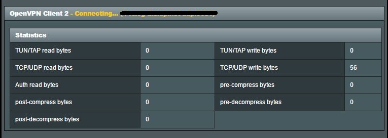

OpenVPN (Client) ist running and the connection seems to work, but the external IP remains the same, whether "All Traffic " or " Policy Rules " .

Has anyone any idea what may be the problem here ?

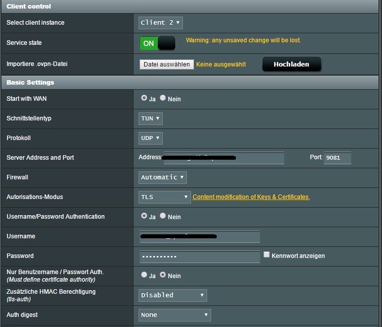

Two things to check....
- Your port number is a non-standard port. You don't say what provider you are trying to connect to, but most only accept standard ports. If that port isn't specified for you, try port 1194
- You have auth digest set to none....try SHA1 or SHA256
Hi John, thank you!!
I try both, but it still not work.
My Provider is Cyberghost, maybe this Info helps.

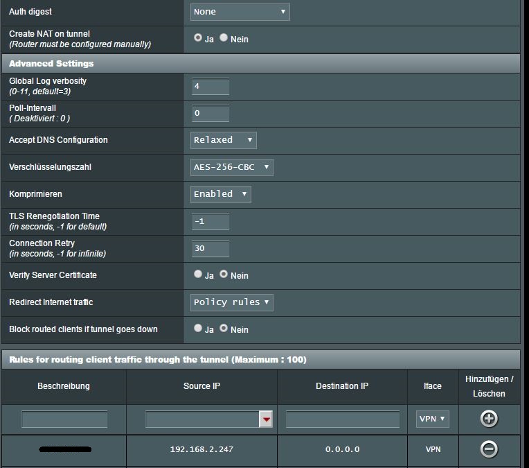

One more question , if I activate "Block routed if tunnel goes down" and the Provider Config is incorrect , the internet-connection of the Client must broke down? I tried this yesterday, but the Internet connection for this Client (192.168.2.247) still work.

Enable accept DNS configurations from Relaxed to exclusive
and enable block routed clients if tunnel goes down.
Also make sure that you put a certificate in authorisation-modus
click on content modification of keys and certificates
and paste the certificate in certificate authority
@ John, yes i used this setup and i also download the keys and certificates, i guess the Sys-Log Shows that the VPN Client connect to the Provider?

even if I activate "Enabl block routed Clients it tunnel goes down", there is still a connection to the internet . In my opinion, the appropriate client is not be able to go "out" , or ?
Therefore, I do not think the problem lies in the connection with the provider , but on the internal configuration .

Did you copy and paste the certificate in the location I specified?
Without the certificate nothing will work.
I think you are having a router conflict because when you put an IP in Policy rules it's not suppose to let you use the Local ISP internet.

I do not know how and why, but when I came home today it works . Only this "Block routed clients if tunnel goes down" still does not work. If the service goes down , I'm with the client suddenly with the ISP IP online . If blocking the line immediately ?
If you turn off the VPN client, you still get internet from your Local ISP?
if that is so then you are having a router conflict. there is no way that should happen.
Turn the Service off and see if you get traffic.
when you enable Block routed clients if tunnel goes down all it means is if the tunnel goes down the traffic will stop until the tunnel is working again.
properly test it and see otherwise I would do a factory reset and go at it again.
its not right if you are getting traffic when the service is off.
