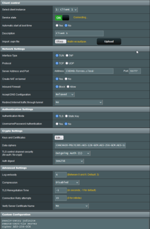

Hello!
I can't connect my OpenVPN client on RT-AC68U router (Asuswrt-Merlin version 386.11) to OpenVPN 2.5.5 (linux) server.
I couldn't connect even after I changed the default port and protocol to 55777/TCP.
But:
I tried to connect from a smartphone with the configuration file as below (Internet provider was also not changed) - this connection work.
I tried to connect from my router with stock firmware - this connection works.
If anyone has come across the same situation or similar or have any thoughts on this situation - please tell me))

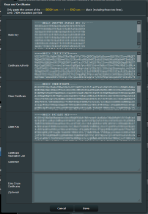

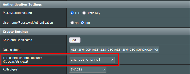

I solved my problem. I removed the "key-direction 1" directive and did as in the screenshot.
