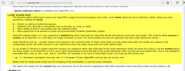

And what does it mean -script security 2 or higher must be enabled? Is that Server side or client side or both? And how to enable it?
Server side - (P.S. you can always read the OpenVPN 2.4 manual from the URL I posted! :rolleyes:)

This is using the RMerlin firmware (as we are in the Asuswrt-Merlin firmware forum!!!)
EDIT: If '/jffs/scripts/openvpn-event' doesn't exist then you must explicitly specify the 'script-security 2' directive.
e.g. Try cut'n'paste the following into the Custom config and see if the Server initialises correctly and the script is invoked for a client connection:
script-security 2
# Customise clients - assign I/P address; share remote subnet etc:
client-connect /jffs/scripts/VPNClientConnect.sh

In regards to the manual for 3.4 I did search it and there was nothing with "-script security 2" I couldn't find that anywhere.
Strange, when I browse the OpenVPN 3.4 [sic] manual (using the URL I posted) I find this...
Did you cut'n'paste the three lines exactly as I posted?
Post the '/etc/openvpn/server1/config.ovpn' file.
Also did you make the script file executable as per the wiki? https://github.com/RMerl/asuswrt-merlin/wiki/User-scripts
Just saw my mistake.. bad typo. Was searching for "-script security 2" and its "-script-security" using Ctrl+F came up with 0 results on this. Thanks for pointing it out :) Yes I did. I didn't include the commented out portion. Just the actual code.
And yes made it executable as noted in previous comment. It shows its executable by everyone. (Groups, Owner, Others)
