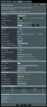

I'm having a problem with firmware 386.4 on my RT-AX88U. I have set up an OpenVPN server, which works as expected on its own. And I have set up an OpenVPN client, which works as expected on its own.
The problem: if I have them both configured, then the server won't start at boot, whereas the client always works fine. The server page shows: "Initialinzing the settings of OpenVPN server now, please wait a few minutes to let the server to setup completed before VPN clients establish the connection." But it never starts.
Some facts:
This configuration worked on multiple previous firmware versions.
The configurations are pretty basic. For the server, I modify the port and the subnet. For the client, I just use a default config file from NordVPN with "exclusive" DNS, kill switch, and VPN director policies. In VPN director, I have my DHCP pool routed through the client VPN and a rule for accessing a maching behind the router from clients connected via the VPN server. See the screenshots below.

I don't believe this would account for the server NOT starting, but there's no need for a rule to bind 192.168.50.151 to the WAN based on the destination 10.99.0.0/24. Remote OpenVPN clients of the router's OpenVPN server will have their replies automatically routed back over its network interface (tun21) whenever they access the local network of 192.168.51.0/24. IOW, that WAN rule doesn't make sense to me.
Thanks for that. There’s probably a much better way of doing what I’m trying to do with that rule, but without it, a client of the router’s OpenVPN server can’t ssh into 192.168.50.151. With the rule activated, it can. Please correct my thinking on this or let me know if there’s a better way to do this.

However, what you've done is resolved the problem by forcing that particular client back to using the WAN's routing table (main), where the OpenVPN server's network interface is specified.
To be honest, I didn't think of that possible solution at the time the problem was originally identified. And I'm wondering if it could lead to other problems. It does seem counter-intuitive since 192.168.50.151 is NOT actually using the WAN to reply back to the remote OpenVPN client. Instead, specifying the WAN simply forces it to use the main routing table, where it actually replies back over the OpenVPN server's network interface (tun21). That's why I became confused, at least until I finally realized the real issue you were having.
Again, I don't know if that's ideal, but at the moment, I suppose if it works, it's fine. I suppose you could just as well specify the entire network (192.168.50.0/24), making everything accessible.
