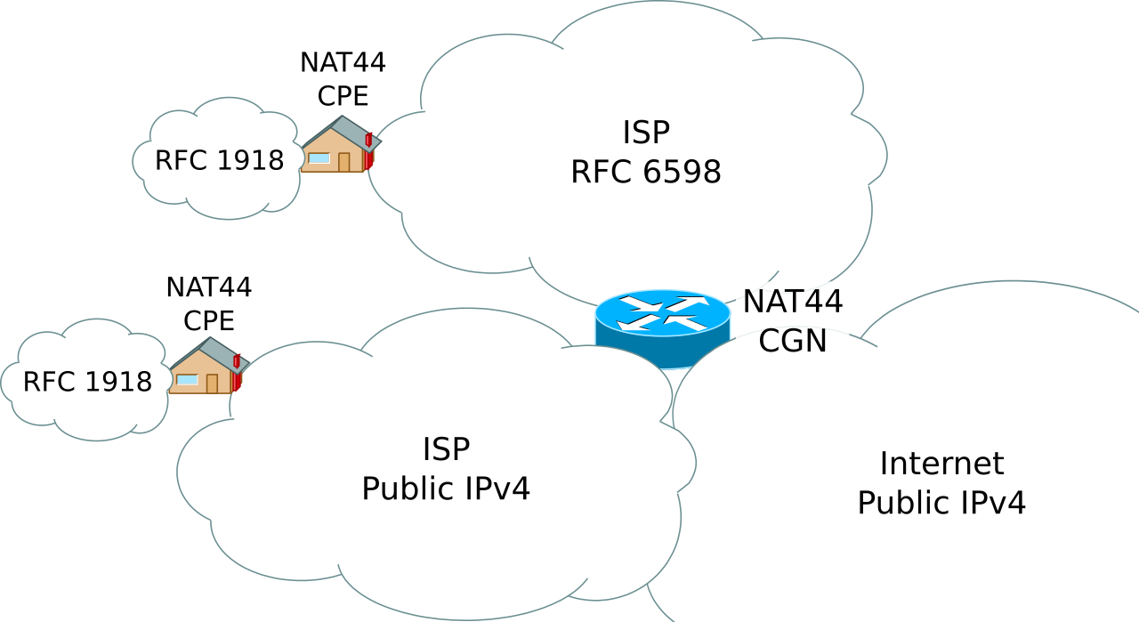

Question: does your wan connection happen to be CG-NAT?
My WAN IP is 100.65.xx.xx
On https://www.whatsmyip.org/ my IP is 155.4.xxx.xxx
What does this mean? Does it mean that all along my problems have been due to the massive ball and chain around my ankle provided by the lovely people over at my ISP?

My WAN IP is 100.65.xx.xx On https://www.whatsmyip.org/ my IP is 155.4.xxx.xxx What does this mean? Is the ISP responsible for me putting the local psychiatric ward on speed dial over this crap?
Since the two addresses are different, I'd say you are likely on a cg nat network. And yes, this would be a 'feature' your ISP provides, and would definitely explain the connectivity issues you've been having with openvpn.
Prior to seeking psychiatric help I'd suggest you confirm the situation with your ISP and if confirmed ask them to provide you with a unique private ip address. Or you could switch ISPs or looking into renting a VSP.
Alright so I downloaded TailScale again, and can connect to my NAS via the 100.xxx.xx.xx IP address on my iPhone. I can also connect to Plex in the iPhone web browser using 100.xxx.xx.xx:32400.
Cool, that means you've got tailscale working.
However in the Plex app, I went into settings - advanced - server connections - and tried adding the IP and port, but get Error 401
Sorry - can't help you there as I don't use Plex, and this issue doesn't arise with Jellyfin. It does sound like something that tailscale and plex will need to fix between them.
This is a CGNAT address and is therefore not accessible from outside your LAN.
CGNAT - so you'll be able to do outbound VPN, but will not be able to be an inbound VPN host over IPV4
I contacted my ISP and got a public ipv4 address from them. I can now finally use OpenVPN and all is well.
