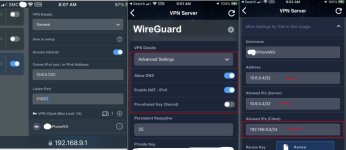

I thought I better update this issue as I am happy to say "I believe" it is solved.
I can access my Router WebAdmin and the Asus App; but not the internet.
Apologies for the delay, took some time getting into it.
  1. First off I never tried 192.168.1.0/24 in the Allowed IPs (Client) settings in the Peers "More Settings for Site to Site Usage" section but taking on board @elorimer comment above I changed my network from 192.168.1.x to 192.168.9.x [with 192.168.9.1 as gateway].
  2. That alone did not help with the stock 0.0.0.0/0 in the "Allowed IPs" field originally; no go.
  3. I even tried both 0.0.0.0/0, ::/0 and 0.0.0.0/0, ::0/0, which I read somewhere realted to IPv6; no go.
  4. I also tried disabling IPv6 completely in my Router's settings; no go.
  5. I also tried changing the port to 563 as I read somewhere some ISPs block ports above 1023; no go, back to stock 51820.
  6. I then mistakenly tried 192.168.9.0/32; no go (I believe for the reasons in "Network Addressing" picture below).
  7. So finally I put in 192.168.9.0/24; and it worked to get to the Router WebAdmin Page, so that was a start. All other items stock I believe.
  8. I still had issues getting Internet Access over the WG connection; but ASUS "Export the WG Profile" in the ASUS WebAdmin has a warning for iOS users, see below for how I fixed this.
I am not sure if this is all correct but it worked!
I still do not quite understand why it always worked on LTE but not on the specific Wifi I was having issues with, but as long as it works I am OK.
I attach some screen shots of my settings <added in bold>.
[Interface]
PrivateKey = <SNIPPED>
Address = 10.6.0.4/32
DNS = 10.6.0.1, 1.1.1.1
[Peer]
PublicKey = <SNIPPED>
AllowedIPs = 192.168.9.0/24
Endpoint = <SNIPPED>.asuscomm.com:51820
PersistentKeepalive = 25
For item 8 regarding this message: "For iOS users, you must assign a specific DNS server to WireGuard app before accessing the internet through WireGuard Server"; currently "DNS servers" on the iOS WG App the DNS shows 10.6.0.1 by default.
So to address this I added the Cloudflare DNS Server 1.1.1.1 to the WG Settings on the iOS Client (in the iPhone App), so it looks like this: 10.6.0.1, 1.1.1.1. That seems to work. See screenshot.
[EDIT] I am not sure I really needed this line "DNS = 10.6.0.1, 1.1.1.1". A router setup from scratch had me inputting this all again and it worked fine with just the AllowedIPs = 192.168.9.0/24 line.
