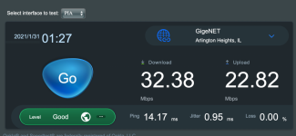

I have the same router. it doesn't have hardware acceleration for vpn. About 30-35 Down and up. Some or all AX models and 86U are faster with VPN.
