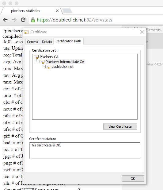

Make it generic. A root CA cert or an intermediate CA cert (sitting at arbitrary level of the trust hierarchy) supplied to pixelserv will all work.
An example of providing pixelserv with a CA cert two level down from the root:
This is fun :-)

For the x86 build :
Added a link in the first post to this How-To.
From my test so far the average processing time increased 5 times (from ~50ms to ~250ms) which I would hope to reduce a bit in the final change.
Pushed optimization to git. Now intermediate CA cert is as fast as using root CA cert! Both shall be <50ms on processing each HTTPS request..on average. Note that your time may vary a bit if you're using a slow USB thumb drive. :)
