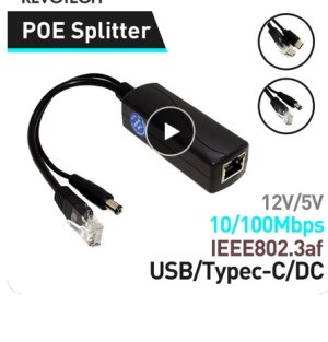

I can power it with a POE splitter
Better use the supplied with the NVR power adapter. One extra device with power conversion - extra cost and power loss.
