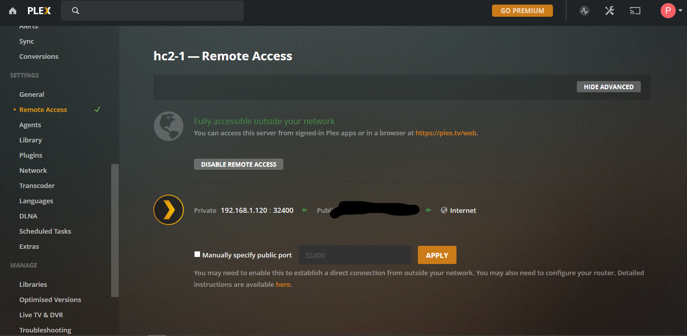

to another computer outside the network with this address: http://app.plex.tv/desktop?secure=0 the server will then be shown as unreachable.
Sorry, I don't know what you are referring to. Can you provide a screen shot?It is displayed for 3 seconds that the port can be reached from there and then is again unreachable -.-

He uploaded a screen shot of that in post #19.Have you set remote access in Plex?
He is running his Plex server on the router itself rather than on a LAN client which makes things a bit more complicated. I suspect his Plex network settings are incorrect. I have asked him 3 times to verify them but he hasn't responded to that.
