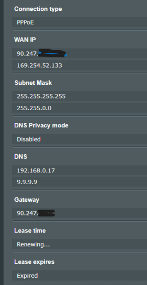

I'm using just an Asus 58U on Merlin Firmware. It has WAN IP then a Gateway which is different again.
What specifically are you trying to remotely access? If it's the router itself, you don't actually port forward in that case since the router is the target. You only port forward to reach some other device behind the router.
If you're trying to reach the router itself, then typically you need to enable remote access to that service (GUI, SSH, etc.) on the Administration page, which just opens a port on the WAN.
If you're trying to reach some device behind the router, sometimes personal firewalls on the target device will prevent the access. Just depends on if it has a firewall, and if it does, how it's configured.
It would help to dump the firewall to see if in fact packets are at least reaching your router. Big difference between no packets at all vs. they get there, but things go awry from that point for some other reason (like the firewall issue above).
