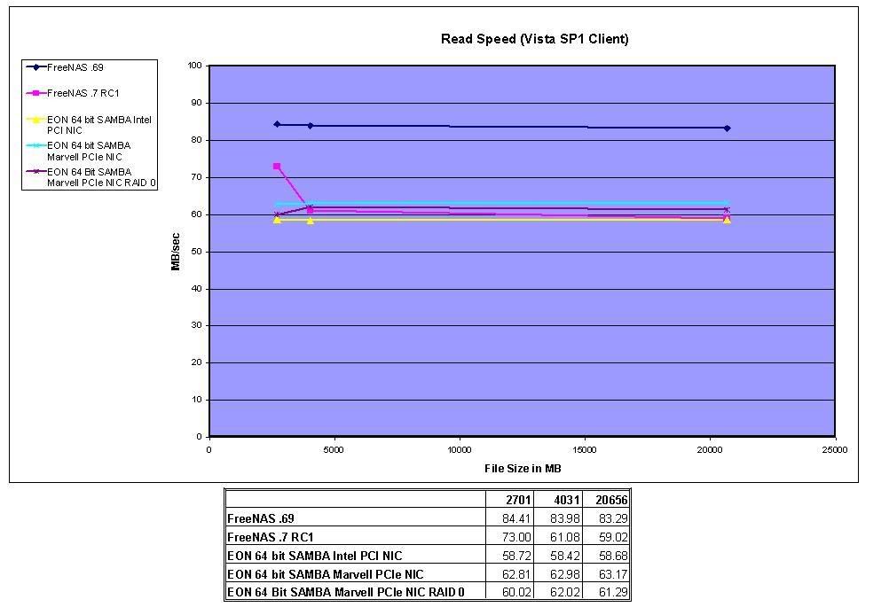

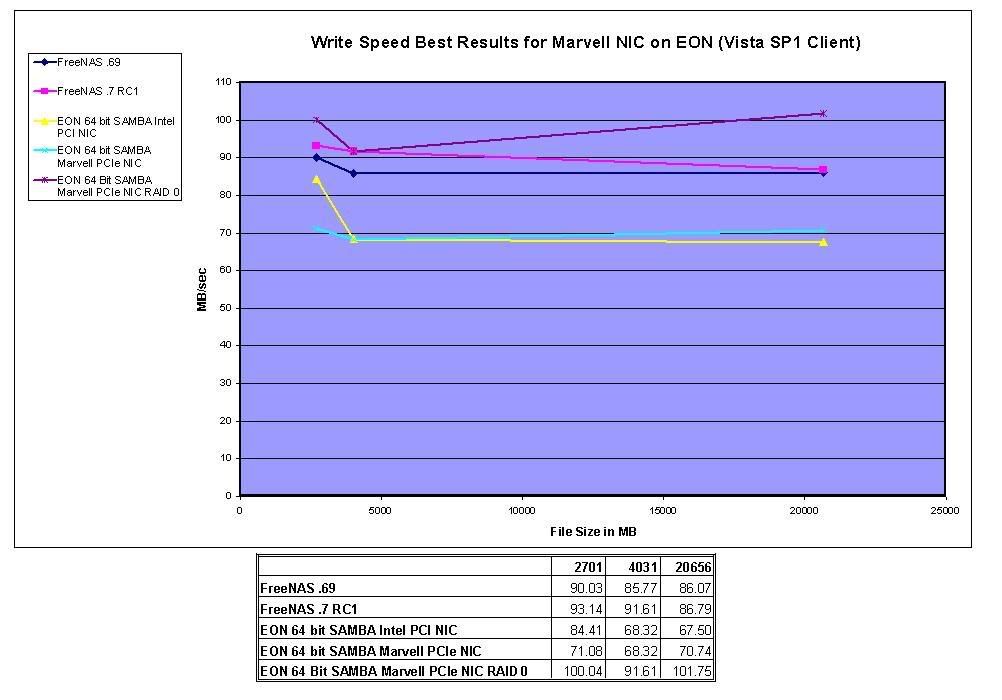

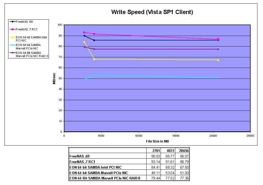

I finally got around to making some charts. Testing has been a little hard... I have been unable to get consistent results with EON. I originally wanted to test the EON 32 bit SAMBA version against the standard FreeNAS version but my results with EON were not really up to par. So I ended up using the EON 64 bit SAMBA version for testing as performance was better but still the results were not consistent. Well I should say write results were not consistent as my read speeds seemed to be about the same even adding another hard drive. I decided to show my average EON results as well as the best write results.
I want to note that on both FreeNAS and EON I changed the send and receive buffer sizes to 65536 for SAMBA.
http://i293.photobucket.com/albums/mm60/dmaster520/readspeed-1.jpg
http://i293.photobucket.com/albums/mm60/dmaster520/writespeed-1.jpg
http://i293.photobucket.com/albums/mm60/dmaster520/bestwritespeed.jpg
First thing I noticed was that FreeNAS .69 had pretty good read and write speeds on my hardware. For some reason .7 RC1 had much slower read speeds... not sure why.
With that said I really do think that with EON performance was being held back by something. First thing I noticed when writing to the EON server was that the network traffic was pausing. When I looked at the stats in Vista I could see that data was blasting across the network at around 100-110 MB/sec for a few seconds and then it would stop for a second or so. This would go on for the whole file copy. On the writes that gave the best results this would not happen at all or would only happen a couple of times. It never seemed to be consistent... I would do one file copy that was blazing fast then move onto the next and it would crawl along pausing every couple of seconds. I mentioned in a previous post in this thread about needing to change from AHCI mode to IDE mode... Maybe that has something to do with it.
