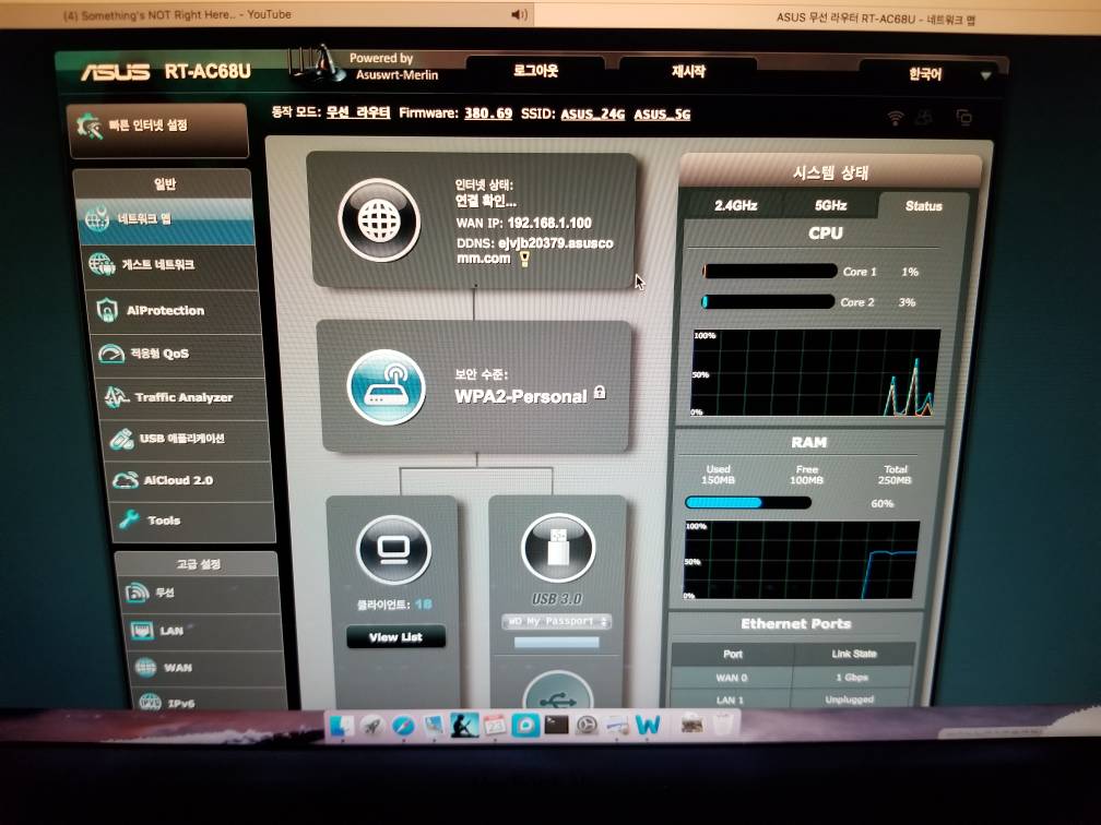

Hey guys, I'm using my Asus AC68u with 380.69 firmware.
I've logged on today and noticed my language was changed to the Asian region.

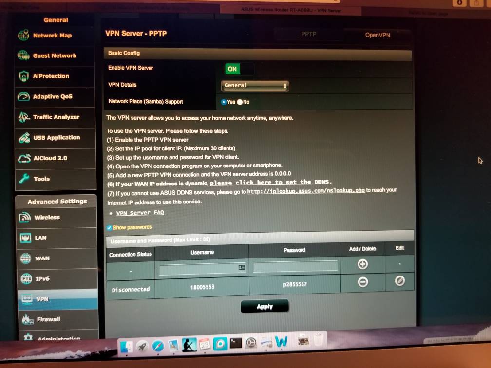

Someone also set up a PPTP and a DDNS.
I have the router offline, but I haven't altered anything.
Can someone assist me. I can send logs and other info to help chase this issue.

What is interesting is your WAN address is 192.168.100.1, so unless that is something you have just changed it would imply that your router is behind another NAT device. This is not a problem, but usually that would make it a lot harder for someone to hack your router from the internet. Unless you had enabled WAN access on the router and setup port forwarding on the other device. Did you do that?
If you didn't already have WAN access working on the router that might suggest that your router was hacked from inside your network.:eek:
EDIT: Also notice how you also have a DDNS account setup on the WAN page (and the "!" indicating that you are behind a NAT). Did you setup that DDNS account?
I made an account today to say that Ive just seen the same thing. I had some issues with internet connections going very slow, so after logging into the router and looking at a few things I noticed a VPN username I didn't recognize. It was very suspect, but I wasn't sure if the router was just going 'wonky'. I deleted the VPN user and a few days later we are still having connection issues and when I login I see that the language has been set to chinese. Still not sure if this is an intrusion or just a reversion to factory default mode, I set the language back and updated the firmware and started researching. Then I found this.
Hey Collin,
I did setup the router to be behind my FiOS router, so I am operating behind a NAT.
My other issue is that I placed the Asus IP address in the DMZ of the FiOS router.
I did not setup the DDNS, or the PPTP account, that was setup by the intruder.

I'm far from an expert, but what I did was did a search on the username created in the VPN access list in the system logs. From there you should see login attempts and from which IP addresses they came from (mine were from China).
All I see is one relatively short login and nothing after that, however, that login was from back in early Feb, and my router language page didn't change to chinese until relatively recently (last week or so). So possibly they were accessing via telnet, not really sure. Do telnet logins show in the logs?
