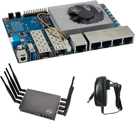

But this Kit from Bananna Pi looks good. But I would beef up the cooling just a little:

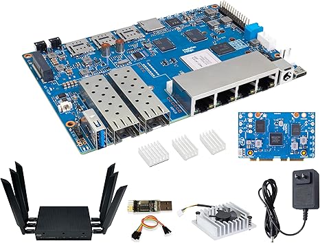

But this wifi6 kit would fit the budget @$150:
