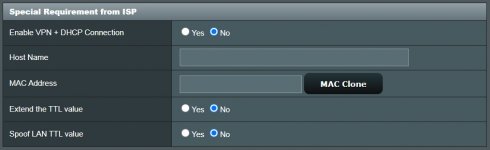

Thanks for the response. I don't know how to check or diagnose why my router doesn't have an active internet connection. I don't use an active kill switch in the VPN client - if the VPN connection is lost, I don't mind, I'll check the VPN functionality when I have enough time. In the WAN I have DNS servers set up not from my provider but 8.8.8.8 and 8.8.4.4 because I read here that it is recommended like this ...
I'm attaching a WAN configuration if needed.

On the face of it, Merlin is right. There is no obvious connection between your WAN connection issues and any OpenVPN client. What I find more likely to be the problem is your having recently changed your ISP provider. I realize you've drawn this correlation between the WAN and VPN, but of the two, the ISP seems more likely to be the issue. And diagnosing ISP connection issues is mighty difficult in the forum.
Have you considered placing the ISP modem back into router mode (at least temporarily), if only to see if it's capable of handling the ISP connection more reliably?
