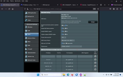

Shouldn't I be able to use Quad 9 on an Asus RT-AX86U Pro via the WAN DNS Settings?
I'm located in midwestern USA. I've used a Cloudflare with similar settings, and was experimenting with new WAN DNS settings with Quad 9. Win11Pro Internet settings show an Internet connection, but apparently my browser (i.e. Firefox) will not connect with Quad 9? Hence the question above.
See Quad 9's DNS settings per the URL of https://docs.quad9.net/services/ and the image attached.
Thanks!

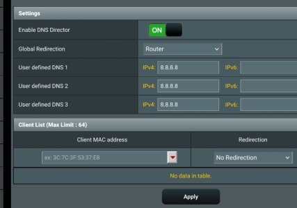

RT-AX88U running the exact same quad9 configuration and Firefox connects fine on win11. What are your DNS Director settings?

OP, I had your exact setup (plus DNS Director’s Global Redirection set to “Router”) a few weeks ago and everything worked fine.

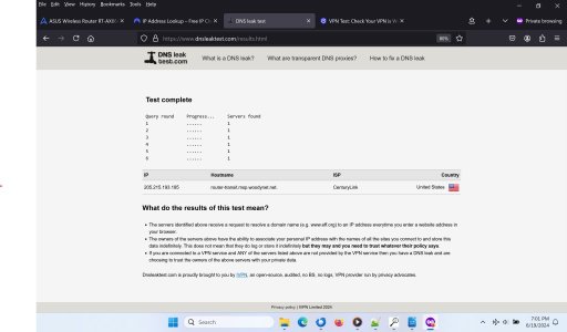

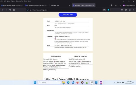

I now have Quad9 as my DNS Server, and using them for DoT queries. The DNS Leak tests provided some puzzling results. However after investigating them I believe the results are consistent with using Quad9. Why?
First, I found this old SnB Forums thead at https://www.snbforums.com/threads/cloud9-dns.56918/ which discusses WoodyNet,
Second, on Quad9's URL of https://quad9.net/news/blog/quad9-and-your-data/ they state they use Packet Clearing House (PCH).
Third, although the DNSLeakTest.com results are not consistently labeled with VPNtesting.com the one IP address does cross reference.

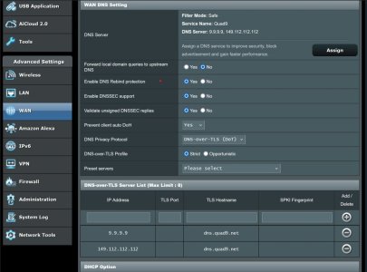

If your interested I've posted the images of DNSLeakTest.com, VPNtesting.com, and the "WAN DNS Setting" including "DNS-over-TLS Server List" via the "DNSleaktest_ExtdResults_Q9.jpg", "VPNtesting_Com_Results_Q9.jpg", and "Quad9_WAN_DNS_Setting_n_DoT.jpg" attached files.
I did further testing with DNS Director on with Global Direction set to Router. One test with LAN > DHCP Server > DNS and WINS Server > DNS Server 1 or DNS Server 2 filled out with in 9.9.9.9 or 149.112.112.112 which wiped out port 853 in the TCPDump results negating the DoT settings on the WAN page.
If I left LAN > DHCP Server > DNS and WINS Server > DNS Server 1 or DNS Server 2 undefined (i.e. blank), then port 853 was the prevalent TCPdump port with only a few port 53 which was previously mentioned verifying use of DoT defined on the WAN page. This may be the same as not using the DNS Director at all. Not sure, but the TCPdump results were essentially the same.
