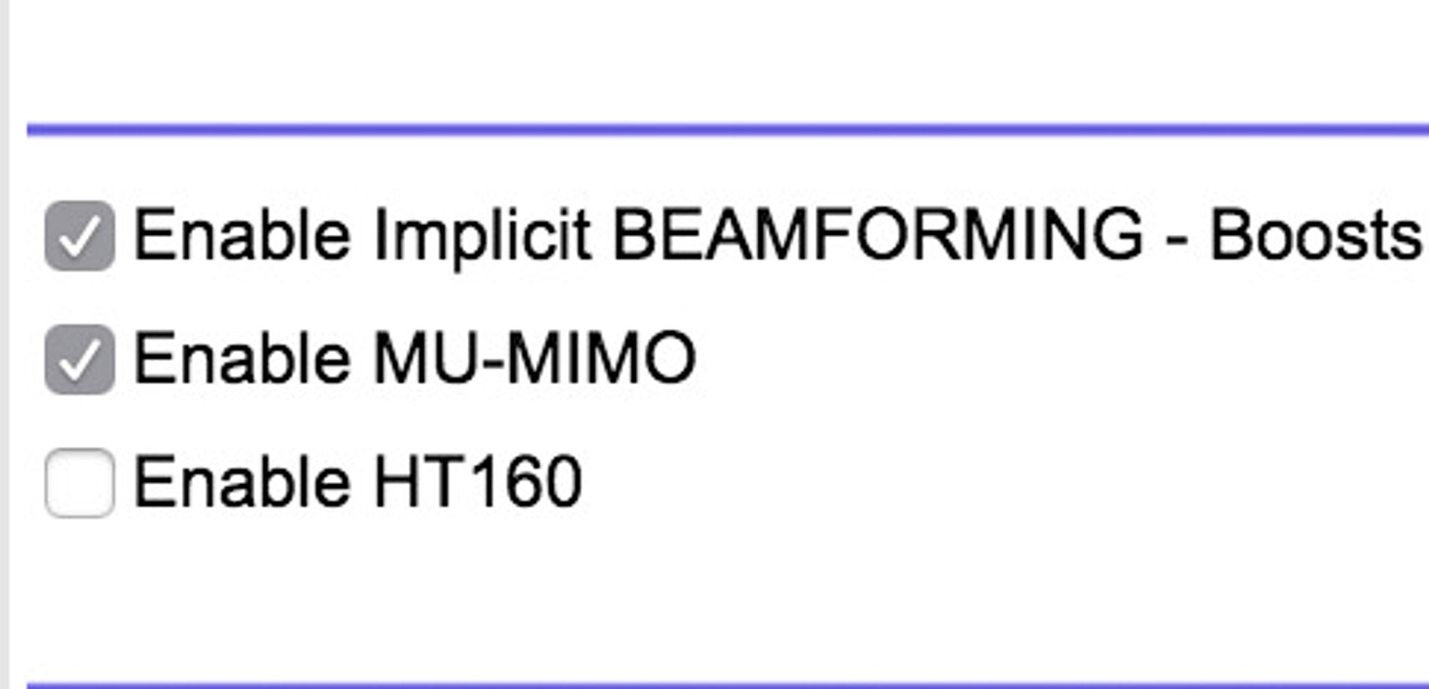

I'm curious how we can see that it is on 80+80, 160 MHz in the stock GUI on 5GHz?
There is no setting to do for 20/40/80+80/160MHz in the GUI?
Beside this settings.
