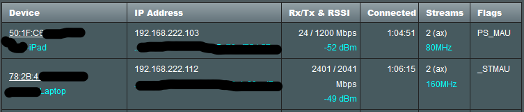

iPad stays at 80mHz, Laptop with Intel AX200 chip stays at 160MHz - the whole day without any drop...

It is not a bug, it is normal behavior.
40 mhz channel on 2.4 is nearly impossible to maintain and also will cause interference with bluetooth and anyone else in the area using 2.4ghz. It will be far more stable, reliable, and probably faster throughput to set it to 20mhz. Not much using 2.4 these days anyway (but plenty of stuff causing interference on it).
160mhz only has two available channels. They BOTH overlap with DFS, which includes airport radar, military radar, and weather radar. A weather plane flying overhead could even trip it. Those radar signals travel for many miles, and if your router detects it, FCC (or your country's regulator along with the wifi standards) regulations REQUIRE it to change to 80mhz and stop using the DFS space. There are very few areas that will not have that happen.
160mhz also has less range than 80 mhz and is prone to outages of several minutes while the router scans for radar signals.
80Mhz AX can get you 800-900Mbit of actual throughput with a typical 2 stream client. If your ports are 1G, that's about all you can expect to get anyway.
If you must have 160mhz, you can try manually setting the channel. There are only two ranges available (channels 36-64 and 100-128), try them both. But most likely you will find they both fail back to 80mhz, and 160 probably won't gain you anything anyway, other than maybe a brief improvement on speedtest numbers. Short of wrapping your house in tin foil, there isn't much you can do if you're in an area that has radar signals.
But in reality, what on your phone is using that kind of bandwidth anyway? Personally, I wouldn't want 160mhz in my pocket or next to my head all day anyway. 80 is bad enough.
That's the most civil and reasonable explanation I can give you, what you choose to do with that information is up to you. But it is not a bug and there is nothing else anyone here can do for you.
