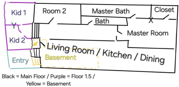

The entire house is wired with cat 5e, all of the cables in the basement are terminated, but the only one that terminated into a room is in the master bedroom. I am able to terminate the one in kids room #2 for a second wired backhaul if needed (the garage is underneath there and people hang out there alot)
This picture took entirely too long to make in hotel on a S25 Ultra with no pen but maybe it can help since I already wrote out the excessively long original post 😅
The black X is where cat 5e terminates in master room. The purple Y is where there's an unterminated Cat 5E in the wall. The yellow X is where coax comes in basement, note that I realize now right above it is the pantry closet so my main router was below the pantry closet though I also got some cable extenders on the way that will put it essentially underneath the door to the pantry so above it won't be a sealed room. Garage below both kids room and extending out, I didn't draw it. If you're wondering why the basement doesn't take up the whole house, there's an attached suite.
So for right now I have 2 Eero 7 Max waiting at home I plan to wall mount one in basement below pantry door but high on the wall, then a cat 5e will run to the main bedroom where another 7 max will be. I can get a third one if needed and run it wireless backhaul in Kids Room 1 or I can try my hand at terminating that cat 5e and having wired.
The last setup I had that did not work well with lots of disconnects was rt-be96u on wall below pantry (by the yellow X), wired backhaul to master room to Zenwifi BT8, and a wireless backhaul BT8 in the small hallway outside the kids room. I was disconnecting in the living room from on my S25 Ultra, Apple TV 4k, Denon receiver, and disconnecting in the master bedroom so I took out the Zenwifis and there seems to be no wifi disconnects, but the range isn't enough and the rt-be96u has gone down and needed manual intervention once so far at this house in the week we've been there.
