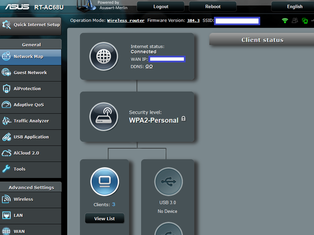

RT-AC68U fw 384.3
Internet status, System Status and Client status do not show anything.

RT-AC68U fw 384.3
Clear your browser cache.
