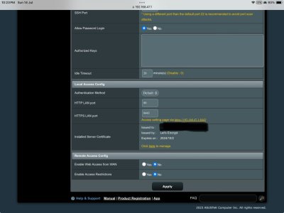

Ok so I’ve exported (what I believe to be) the Let’s Encrypt certificate from the WebGui login page that shows up and installed it as a Trusted Certificate in Chrome Browsers on my desktops and in Safari on two iOS devices.
The http access remains considerably faster than https, which is nigh unusable.
Should I be using a different certificate ie not Let’s Encrypt?

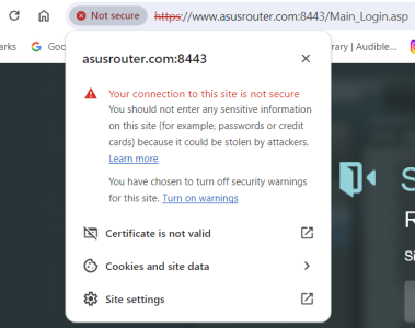

Are you sure you're using a valid certificate and URL? What do you see in the browser?

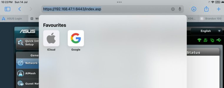

I’m pretty confident yes. I don’t use https://www.asusrouter.com:8443 as that resolves to my local router, whereas 192.168.47.1 is my remote router (via a VPN).

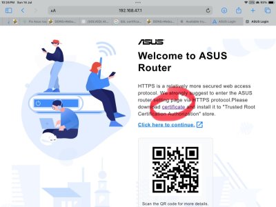

But certainly when I changed between http and https on that 47.1 address I got the message about downloading the certificate and installing it to Trusted Certificates, which I have done (for both my routers), for use in Safari in my iPad. For my Chrome browsers on Windows I followed the method in Adamms linked reference.
But when I toggle between http and https access in the Admin the snappiness of the WebGUI is markedly different. Admittedly the remote router is only on a 300/100 connection but I tried both via Wireguard direct and Tailscale (direct not DERP) and I don’t think it’s the VPN that is slowing it down.
