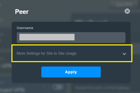

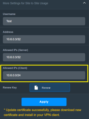

@postoronnim-v try the following. It will likely involve having to generate a new set of Wireguard client keys and you'll likely have to import the new keys on the client device.
In the Wireguard server section create a new client or edit an existing client. When creating the client select the More Settings for Site to Site Usage option. For an existing client select the More Settings for Site to Site Usage. Then change the Allowed IP's (Client) value from 0.0.0.0/0 to a value like the following 10.6.0.0/24 (adjust for your settings). Apply the settings. Then either use the QR code option on the Client app to import the Wireguard client keys or export the client keys and import them into the Client app. Then connect the Client app to the Wireguard server and test if you can access the router or any local network clients.
Example More Settings option on Wireguard Server Client page.
Post edited to correct value for Allowed IPs (Client).

Then change the Allowed IP's value from 0.0.0.0/0 to the same value as Address and Allowed IP (Server).
This didn't solve the access issue. Furthermore, this setting isn't transferred to the client (it doesn't work), and changing it on the server doesn't restrict access.

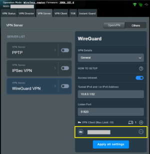

@bennor those settings don't exist on the RT-BE88U.
What does your WireGuard Server screen look like on the RT-BE88U?
Here is how it looks on an RT-AX86U Pro.
Did you create a new Wireguard entry on the client device with the new changes that were applied on the Wireguard server client entry? Did a quick test and it appeared to work on my end to block access to the router when using the Address value that ends with 10.x.x..0/24 as the Allowed IP's (Client) value. See example above.
