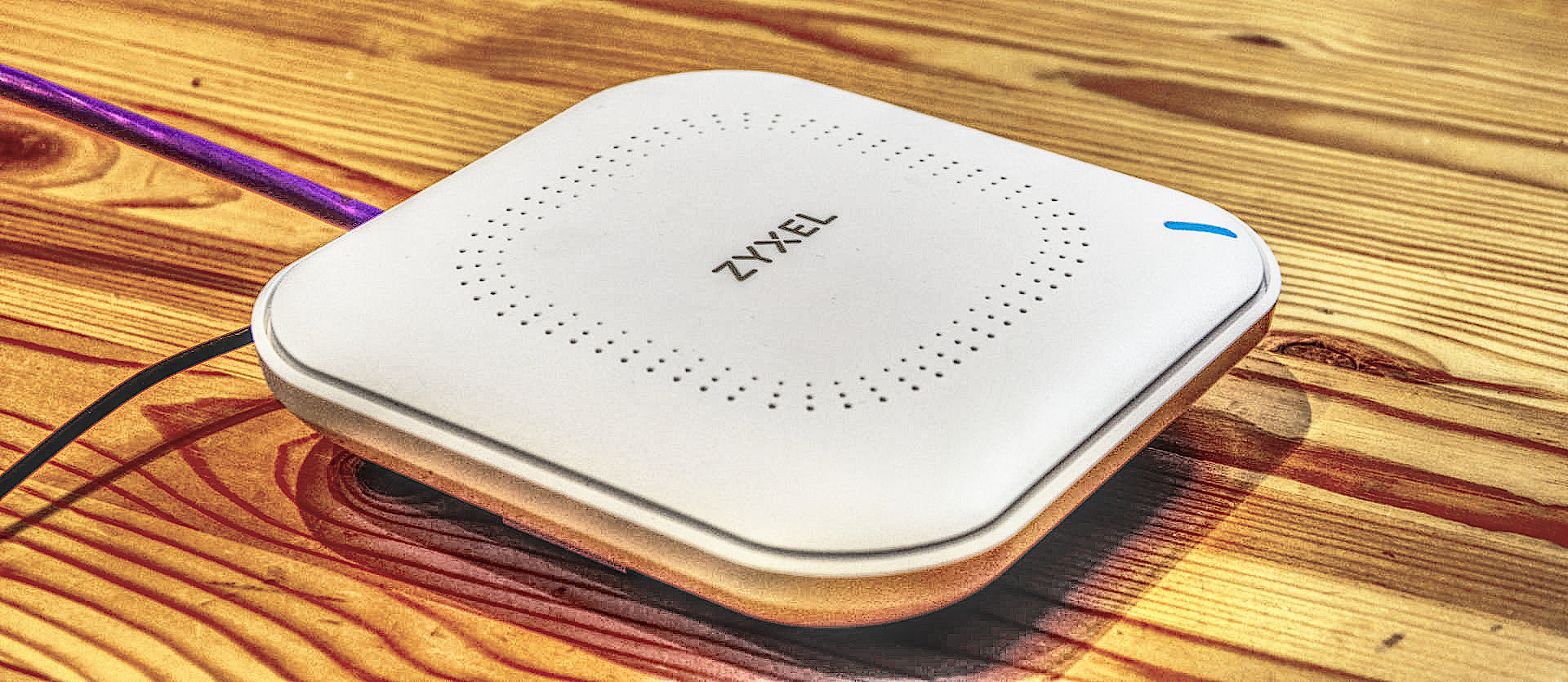

I don't know what you can get for ~100€. I do know that an AP w/o the router components typically performs better due to running cooler, mor ram, and better RF radios / antennas.
Using an AX AP though is where you need to be if you're making a one time investment and want it to keep up with devices as you replace them over time with newer tech embedded in them.
Look beyond the regular suspects in the consumer market though. Zyxel isn't something someone typically knows of because they're not usually sold in the big box stores. Looking at the SMB minded gear is where you'll find better options. There is the NWA110AX which is a 2x2 radio setup that is cheaper but, they're also making different models now compared to just 2 years ago when I picked up the NWA210AX.
nwa90az - 1ge port / ~$100
nwa50ax - same / $75
https://www.amazon.com/dp/B09924QS1T/?tag=snbforums-20
If you want faster than 1GE speeds though you need to up your budget a bit. Having a 2.5GE port is what gets you faster speeds on your LAN and WAN if your ISP plan supports beyond 1GE speeds.
