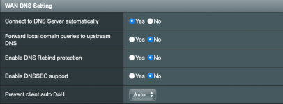

using default ISP resolvers with DOT from provider ControlD, it works fine most of the time but ever since upgrade to 386.2_6, DNS queries fail from all devices intermittently , traceroute to router fails, checked with 2 diff routers, both have same issue.

try disable DNSSEC
I agree, or any other "secure DNS" as I've had similar issues. For me the random loss of DNS was many days aapart.
