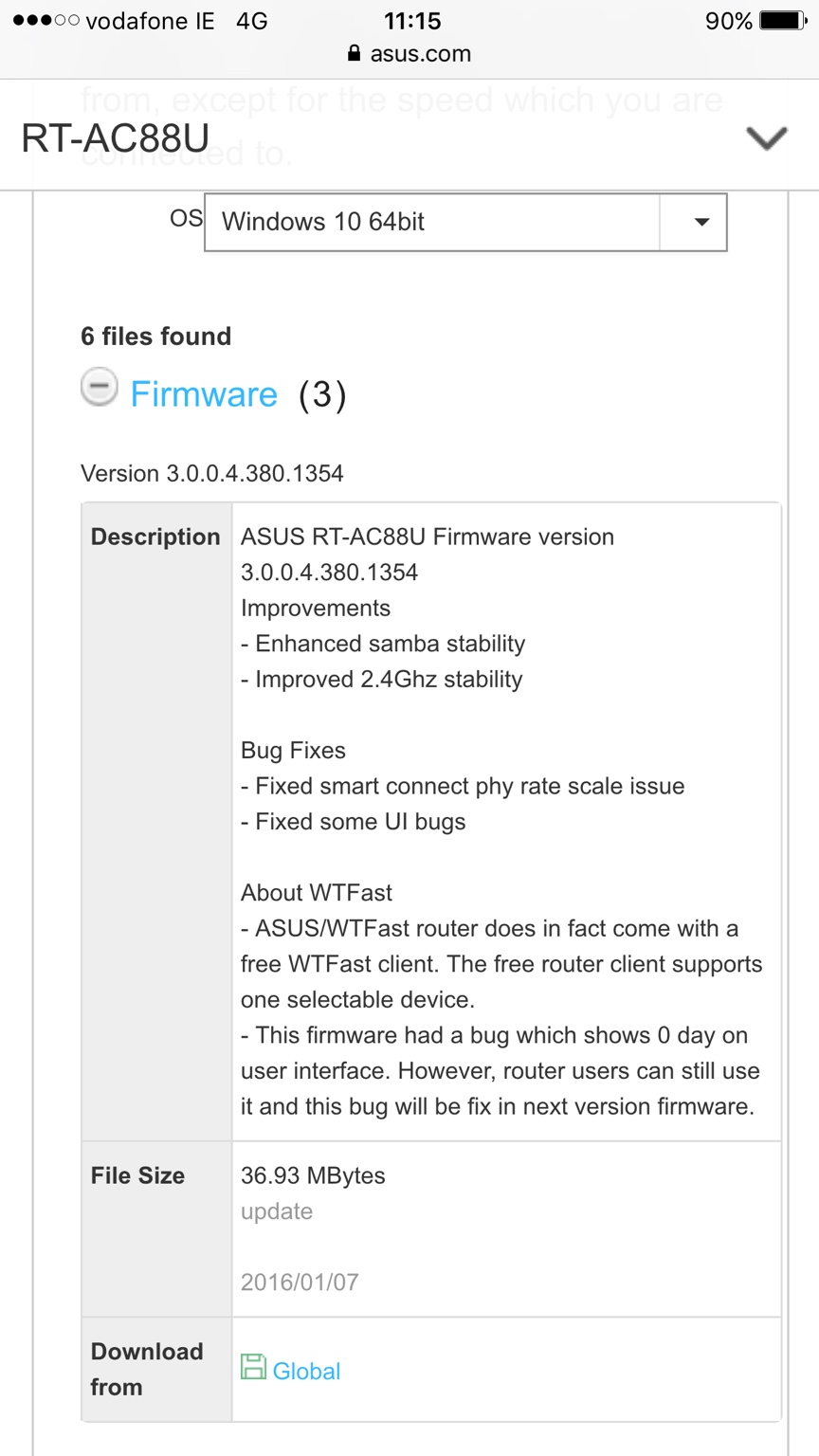

380.1681 was emailed to me today. Said they fixed the reboot issue and improved wi-fi stability.
Should we expect official firmware update any time soon? To be honest, mine is rock solid and I cannot complain. 13 days uptime and no problems.
Not sure when an official firmware will be released. Since these are still Alpha builds I would recommend sticking with 380.858.
Sent from my LG-D850 using Tapatalk
Don't be lazy...
Asus product page -> support -> Driver and tools
I'm not, just that on my phone it was not showi g up on drivers&tools -windows10 section...
Thank you for the info!
Sent from my SM-G900F using Tapatalk
I am on the phone too.
http://dlcdnet.asus.com/pub/ASUS/wireless/RT-AC88U/FW_RT_AC88U_30043801354.zip
