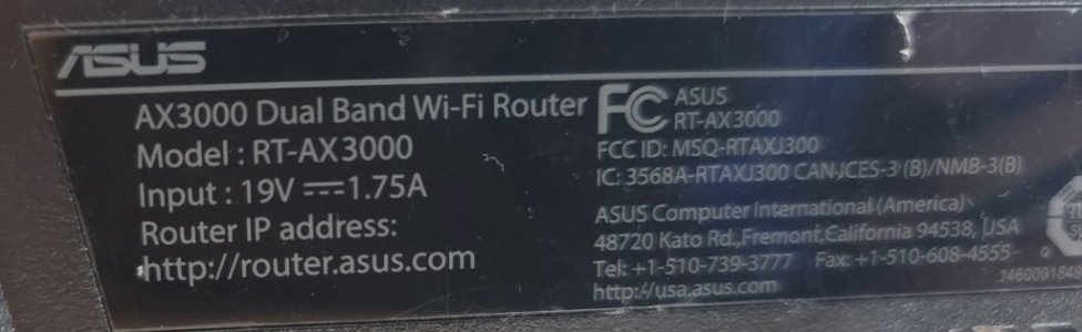

The router is indeed RT-AX3000. The firmware currently installed is the latest version, 'ASUS RT-AX3000 Firmware version 3.0.0.4.388_24762', which was released on April 12, 2024, on the ASUS website.
