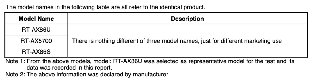

I've spent some time scouring FCC documentation for these models (and also the GT-AX6000) and updated the wikipedia page to reflect the components used per the teardown pics
Key tech differences:
  1. AX86U has 4 vs 2 core CPU, same speed at 1.8GHz
  2. AX86U includes an extra 2.5 Gbit ethernet port
  3. AX86U has 2 USB 3.0 ports vs 1 3.0 and 1 2.0 port
  4. AX86U has 1Gb Ram vs 512Mb
  5. AX86U-Pro has a faster quad core processor vs the U and S
According to Asus's own testing, wifi (specifically DFS) is the same across the models. Check page 9 here
So rest assured, if you are looking at any of these models, unless you can utilize the added hardware, there is no benefit to stepping up to the U/Pro.
According to Asus's own testing, wifi (specifically DFS) is the same across the models. Check page 9 [here|https://fccid.io/MSQ-RTAXI600/Test-Report/Test-Report-DFS-5347368]

Which chipset model number incremented? According to the teardown, it's the exact same chipset for 2.4 & 5G wireless. The only change was to the CPU from what I see. Also Asus published testing results stating that wireless performance is the same across all units.
As implied by bennor, there may be a firmware split between the Pro and the U/S with the Pro having more features. Its not yet clear though whether the 3.0.0.6 firmware will be exclusive to the Pro series and the GT-AX6000. Another factor is that the Pro should be supported further into the future because its newer. And the 2.5 gbps WAN and LAN ports offer some future-proofing. So I think the decision is not as simple as whether someone needs the additional hardware features.
I can post chipsets model numbers later as I don’t have them. Multiple reviewers have already benchmarked the non Pro vs Pro and noted small improvements with the Pro. I have first hand experience and saw similar improvements in my home.
Any performance improvement is perception only according to Asus. There are small gain differences in the antennas but Asus's submitted documentation on DFS, 5G, and 2G testing all have the same claims that the performance is identical:
Depending on the SKU, you might get a Qorvo vs Skyworks 2.4G FEM or Broadcom vs Realtek 2.5G PHY (U & Pro). There are other minor variances with the power supplies provided.
He was talking about his RT-AX88U Pro router (MSQ-RTAX6800) vs. the non-Pro version (MSQ-RTAXHP00).
