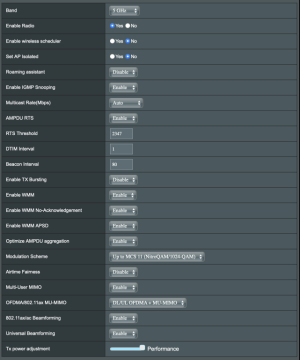

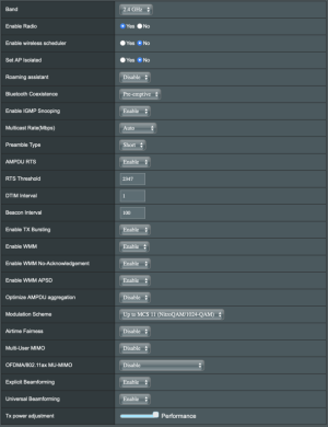

Further information based on what you've shared (and thank you for sharing!):
  • No scripts
  • No AiMesh
  • I do have a Devolo powerline adapter to extend the network to the next floor (2-floor apartment with 12" thick concrete walls and 24" thick floors/ceilings), however my partner who has more calls than me and experiences more blips has essentially line-of-sight from her laptop to the Asus.
  • No USB drive attached
  • SmartConnect is on in an attempt to fix the blip issue, assuming the 5Ghz connection was dropping out and that switching would be better.
  • WPA2-Personal for authentication.
  • 5Ghz using a fixed control channel with 160Ghz enabled.
  • 2.4Ghz using a fixed control channel, 20/40 MHz selected.
Professional Settings for the 2 bands attached.
Go back to the WIFI defaults. Use dual band smart con̈ect, set the 5 GHz to 80 MHz on a fixed non DFS channel.
I have the control channel set to 136, I'm not sure whether that is a non DFS channel.
