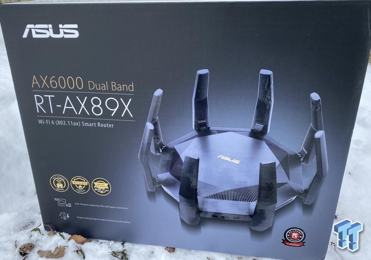

The router ran with the fan off for 2 hours and the max temp flatten out at 140 deg F. no crashes. Check out the Tweaktown review "the quickest router they have test so far (date 11/2020)"
