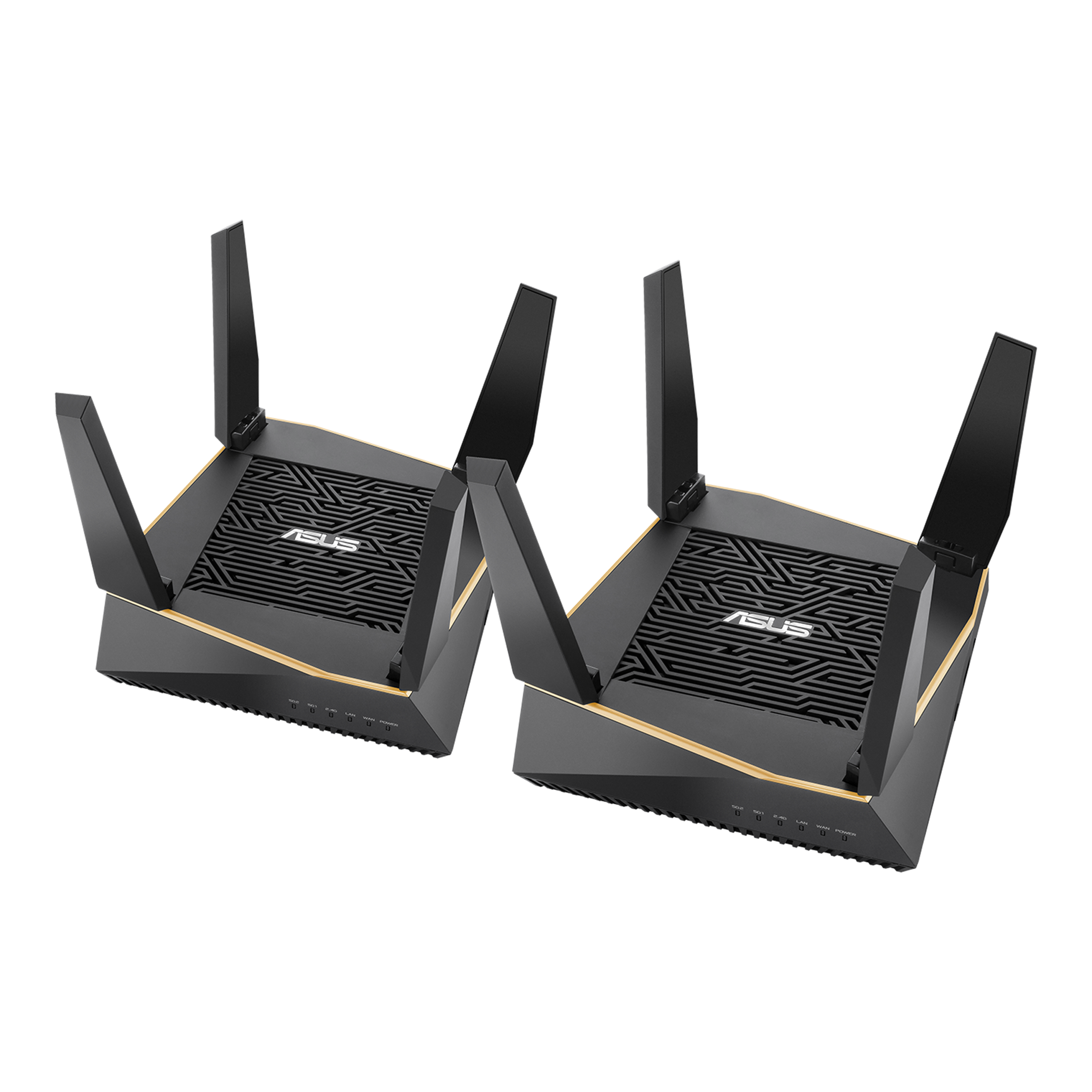

Also, I still see the AX92U in Asus web site:
Asus has them in stock: https://store.asus.com/us/item/202005AM280000004
Retailers that have them in stock: https://www.asus.com/us/Networking/AiMesh-AX6100-WiFi-System-RT-AX92U-2-Pack/wheretobuy/
No mention of EOL'd.
