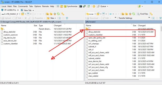

As noted a few times in various posts I’ve been using WinSCP and just saving several files from the router containing dhcp reservation details, then copying them back into /jffs/nvram, for many years, without issue.
For one fixed DHCP list (under the LAN, DHCP tab) that 3004 FW had, it worked fine for me (although I will admit @Tech9 noted some concerns).

  2. Using WinSCP by just copying (drag and drop) the dhcp_staticlist and custom_clientlist files from /jffs/nvram across to a local drive (and back when you needed to); this was my preferred option, see attachment.

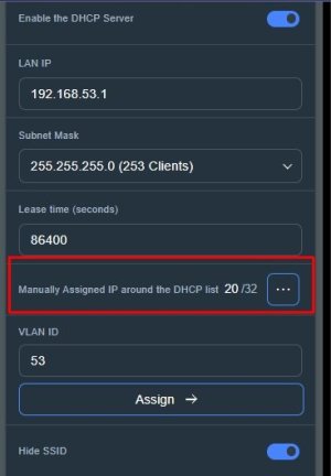

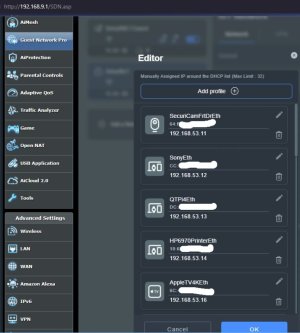

However with the advent of additional lists in Guest Network Pro VLANs (see attachments), albeit only 32# for each VLAN (think lots of IoT devices...), I am unsure where these additional lists are saved. I looked in the dhcp_staticlist and custom_clientlist files but they are not populated with Guest or IoT VLAN DHCP details. The original ones (for the Primary Network) remain unchanged however.
So, does anyone know:
(i) where these new lists are kept; and
(ii) can I download them or access them as before and upload replacements if I ever do a factory reset, without borking the entire system?

I am happy to input most setup details from screencaps, but the total 64# DHCP in the primary network PLUS now up to 32# (times five VLANs???) is a lot of IP Addresses and Custom Names to enter back by hand.
