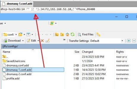

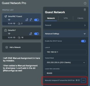

The reason was that I had 1 (one) leftover manually assigned IP which I did in the GNP Gui (GNP, Advanced Settings, Manually Assigned IP around the DHCP List) earlier, before I started using dnsmasq-x.conf.add referred to above.
However I forgot about the addition of a Manual IP assignment done via the GUI and went ahead and added a manual assignment to dnsmasq-1.conf.add (being the first VLAN, VLAN52). I cannot recall if it was the same MAC or IP or not.

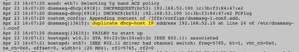

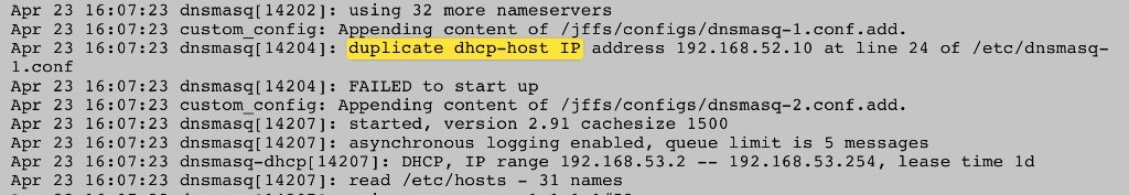

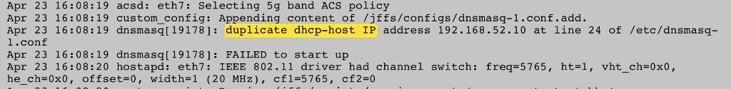

If you still have the syslogs from that time, there should be a “duplicate dhcp-host IP address 192.168.52.10” in the logs to show that the SDN dnsmasq instance failed to start up. Therefore, DHCP wouldn’t work, and you’d end up with an APIPA address 169.254.x.x.
How do you even know this … I completely forgot to check the logs but even if I had I’d have no idea what I was looking for.
My troubleshooting seems to involve 1000 hrs of trial and error and you clocked it in about 2 seconds flat. So annoying. I’m going to have to put freddyjuarez on to you just to keep you occupied.
