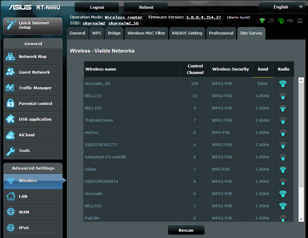

Is there a way, perhaps from the command line, to scan for wireless signals inside the RT-N66U unit? Yes I realize there are many Windows/Mac packages that can do this. I am in a situation where I need to remotely support an ASUS RT-N66U unit and it would be nice if I could have the router tell me what 2.4Ghz and 5Ghz bands are in use in the vicinity.

Tomato has such functionality. I don't know about Asus Merlin build, may be RMerlin will answer.
This is something I want to look into adding at some point. Most of the code is already there, I just need to develop a UI around it.
Thank you! Thank you! This is exactly what I was looking for.
Can you confirm this scan 5Ghz channels as well? When I try this remotely, I only see 2.4Ghz channels (which may be all there is).

I use an app called inssider to scan my networks where I live. They have for phones and laptops, etc.
There is not a sinlge 5ghz signal in my area.
It will report 5 GHz APs so long you do have 5 GHz wireless enabled on your router.

Wow! That's really great... a very helpful feature indeed!

Nice job!!!! ... and what a tease! That does look fantastic! I look forward to it to being part of the firmware.

Most of the code was already in the firmware. Asus implemented this for the Quick Internet Setup wizard so you can select a target router to connect with while in Repeater mode. The trick was just to wrap it in a regular ui.
There's still some issues to work out however before it's ready.

fastest way from windows PC is
from the command line use
telnet <router ip>
login using admin login
then type the commands
