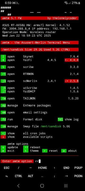

You're attempting to update scMerlin from version 2.4.1 (hosted on @JackYaz's GitHub repository) to the latest 2.5.8 version (hosted on @thelonelycoder's GitHub repository). It looks like AMTM is not currently prepared to make the automatic switch between the different GitHub repositories.
The easiest solution is to un-install the current 2.4.1 version, and then re-install via AMTM the latest 2.5.8 version.
HTH

I came here to ask the same thing
