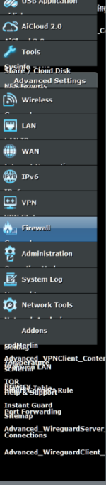

Webui ok now after few reboots. was a little worried all good
uninstalled reboot re installed working scribe .BUT Gui not looking good
Next time try ctrl+f5 in the browser you're using.
