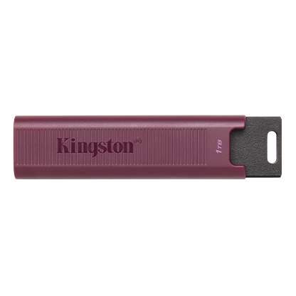

Flash drives vary in their durability depending on brand but as far as I can tell, the Samsung Fit Plus USB 64GB, 128GB, etc should be able to do the job without issue. Operating temps need to be below 140 Fahrenheit or 60 Celsius. Mine operates around 110 F. USB warranty covers 5 years, which shows their confidence in product reliability. -Although I couldn't verify if warranty is voided by R/W life cycles, their warranty page only shows their standard line of permanent storage warranty is voided if you exceed the W/R amount, the external drives however are covered by how many years. If it fails before 5 years, I will see if they will replace it. I figured that since the capacity is such a low amount that this particular USB would suffice for the job. If anyone has this configuration I'd be interested in your mileage if over 2 years.
If the USB does have the capabilities for the job, an important test would be to stress it to see if it does stay within operating temps, otherwise the heat will certainly cause W/R failures
I typically have gotten the best results with these two flash drive:
But I have gotten good results with this one as well:
The Samsung Fit Plus is pretty good too.
But I currently use a Samsung SSD.
