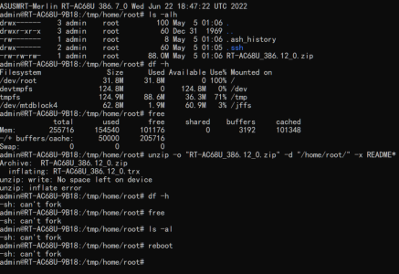

Guys, RT-AC68U testing is not going well. I just uploaded the firmware (zip) from sourceforge to tmpfs (via scp), the decompression seemed to cause a lack of RAM and eventually I couldn't enter any commands and the GUI was inaccessible and I had to do a hard reboot.
EDIT:
I have tested it several times with the same result. It may be that the RAM is not enough.
The firmware zip size of RT-AC68U is 90MB and the RAM is 256MB. Usually the RAM usage does not exceed 70MB without USB. So decompressing the firmware is a bit troublesome because it can easily consume all the RAM.
EDIT2:
New test:

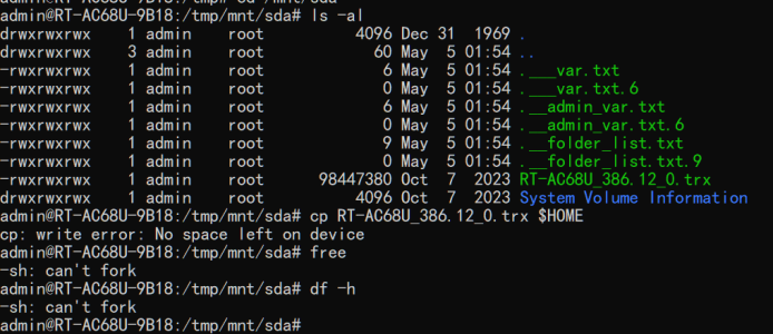

Test environment: RT-AC68U connected to USB
Test purpose: Copy the decompressed firmware from USB to tmpfs, and then use curl to flash.
Issue: Unable to copy, various system tools and GUI errors or crashes again.
This makes me wonder, why can't I copy the firmware from USB to tmpfs? At this time, the RAM is more than 120MB free, but a 90MB firmware cannot be saved?
EDIT3:
I'll do some more testing later If it is determined that RAM bottleneck is the cause of this, then we will have to restrict the use of this script on some low RAM models, otherwise it may really cause glitches. In my case, when SSH showed "-sh: can't fork", it seemed that the shell crashed, and then the GUI also crashed and failed to load or part of the content could not be displayed after loading. Anyway the router started acting weird and had glitchy functionality.
Since this crash is not self-recoverable and can only be resolved by a power restart, we have to assume that such an issue may occur on other routers and try to find the trigger (probably RAM) and avoid it before it happens.

That's the problem, I think when I was copying from the USB, the router read it into cache first, causing the tmp space to decrease, and ultimately causing the copy to fail. But this caused the system tools to crash and I don't know why.

I had a similar issue when experimenting with decompressing, I had to decompress in the home/root for me, other system locations would give errors of either no space or no permission.

You're right about the file size, don't forget the system takes up 70MB (without USB), so 256-185-70, so we're running low.
I read the source code, so I also put my test in the /tmp/home/root directory. I want to manually enter the commands to see if it works, and then test the script next. But I didn't expect to encounter such an error at such an early stage.

I actually have no idea what's going on right now, everything looks broken, the SSH session is not disconnected, but typing anything just returns "-sh: can't fork" which seems to me to be evidence of a shell crash . The GUI is also inaccessible, or cannot read the memory usage after accessing it, because that part crashes as well.
Can you think of a test method? How do I diagnose the problem?

After the shell crashes, no commands can be executed.

No, I haven't gone that far yet, all I have done now is put the firmware in /tmp/home/root and unzip it. I just want to do manually step by step what the script does.
But I did test curl before, curl can log in to the GUI correctly to get the cookie.
Now both tests I'm doing are getting the same error: The first test was to upload the zip firmware to /tmp/home/root using scp. There was no problem after uploading, no exceptions, but the decompression failed and it reported insufficient space.
After that everything crashed. I just had to turn the power off and restart it.
RT-AC68U was specially used for debugging for this project, so it was restored to factory settings and almost no other settings were made except turning on SSH/turning off WiFi.
The second test was to put the unzipped firmware on a USB drive and then copy it from the USB to /tmp/home/root in the router. As in the second screenshot above, the copy again reported insufficient space.
After the shell crashes, no commands can be executed. But please note that the SSH session is not disconnected at this time.

I tend to suspect lack of RAM for this error, but I could be wrong, as with the previous nohup, I also initially blamed it on lack of RAM. In fact I care so much about available memory that I might derive the wrong evaluation.
If there's any way you guys can help me determine the cause of the error, I'd love to try it tomorrow. I'll run more tests tomorrow and provide more details, sorry I can't test anymore today.

First of all, I find this all very valuable data, because already we have a baseline of hardware specs we can expect to function correctly, and a baseline where things can get "weird." as you say.
Now, I understand that you were just going through the steps one by one as described in the script, however now that we have an issue we can break it down.
To troubleshoot, what if you simply skipped the unzipping and even the zip files all together? Don't have them on the USB, or home/root or anywhere on the router.
Start by unzipping at your computer, and copy it via SCP to home/root. The same way you did with the zip the first time successfully. Make sure there is no zip, if there is delete it first.
What I may need clarification on, is you say the zip file copied no problem via SCP, but the unzipped firmware didn't copy via USB successfully due to storage issues. (Did we attempt the same method via SCP?)
The different between the two in size is negligible (91MB vs 93MB) so this lends me to believe that you left the zip there while you attempted to copy the unzipped firmware, this is good for testing the script since this is what it does, but what if we skip the zipped file all together to break it down now that we have an issue.
Put the firmware file as the only file in home/root and test the curl commands manually?
What this will do is narrow the issue done specifically to the unzip (either storage or RAM).
If the single firmware file is already there and unzipped, and the curl login and flashes is successful, we know that RAM is not a concern for the actual flash. But maybe still for the unzip.
I don't think storage is the issue since our models have the same amount, however to narrow down from there, we can test having the zipped firmware on the USB ( like it will be as per our expected backup solution) and simply unzip the firmware to home/root via command, where it should have enough storage (alone) and we will know that the rest of the process should work successfully since you already tested it manually.
If that works, then we know the issue is storage related, and we would maybe need to download the zip the the USB and unzip to the home for the flash instead of doing it all on the home directory.
If it doesn't work, then we know the issue is related to memory while unzipping since the root/home is empty and the difference is basically nothing between zipped and unzipped.
By the way, feel free to do those troubleshooting steps in whichever order you rather the manual flash test, or the copy tests.
The only reason I suggested that order, is that if the flash fails, there is not much point in troubleshooting the flash prep, especially when you handle all the pre-flash prep manually and the setup is ideal for the flash.
However if we know the flash can succeed manually with an ideal setup, then there is still hope and we can then further troubleshoot the unzip with storage and copy tests.
