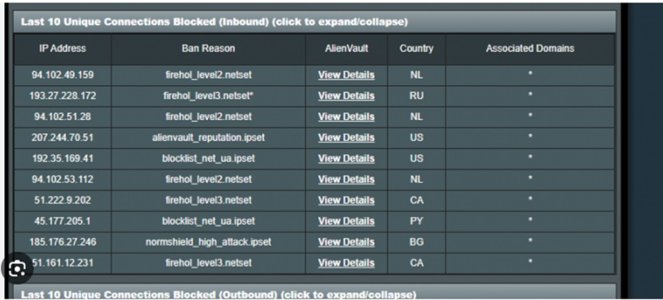

I have recently installed Skynet. After a few days of running Skynet, I could see a lot of unwanted hits originating from Bulgaria. So I decided to Country block Bulgaria (BG) and see what happens. Well, the number of hits from Bulgaria continues to increase, even though I thought that blocking that country would do just that and the hits would freeze at the. Question1:- Is this a normal?
See the screenshots. On my Asus (skynet2.jpg) I do not see any country information. Yet, I found another thread from another user that does show the country information (skynet.jpg).
Question2:- How can I get my Skynet instance to show country codes?
Question3:- Just curious, can the Stats be reset to zero?

You mostly got visibility on what was blocked by the firewall, with or without Skynet on top. You are not under attack and careful with blocking EU countries - large Internet hubs and data centers there serving various Internet core services. You may hurt yourself as usually happens with IP-blockers. Skynet is a great tool, but only if you need it, know how to use it and have the ability to troubleshoot eventual issues with community blocklists it relies on.
Skynet will still count knocks at the door.
If we look at the readme....
  • firewall settings lookupcountry enable|disable: Enable/disable country lookup for stat data.
If we look further down on that same readme..
  • firewall stats reset: Reset all collected logs.
Thank you very much for the details. I installed skynet using amtm so never saw the readme. But I have found the readme that you mentioned. here :- https://github.com/Adamm00/IPSet_ASUS
I used firewall settings lookupcountry enable, and it confirmed Country Lookups For Stat Data Enabled (however, so far I am not seeing any country in the Asus/SkyNet UI - maybe this takes a while to start working?)
I also tried firewall stats reset. - works.
Subsequently found that both commands are available using amtm skynet menu's 13-4 firewall stats reset and 11-13-1 country lookup for stats

Thanks to all for the info. I do not have the technical ability or indeed desire to deviate from the Skynet defaults. Right now, the home system works great and using Skynet and Diversion plus the Asus's own Aiprotection, firewall etc makes me feel secure.
One side note is that despite Skynet [13] --> Stats Country Lookup | [Enabled] I am still not seeing any country information in the Asus UI last 10 connections blocked. Even after 24 hours of running. It's not really an issue. But wonder why it's not working.
