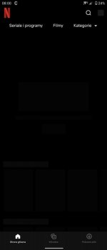

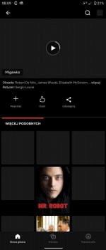

If Skynet would block Netflix you would have seen blocked logs in "OUTBOUND" direction; not "INBOUND". Depending on screenshots; there are two possible reasons;
- Your DNS server is can not resolve the addresses . If your are using DOT or etc. try disabling them or try using a different DNS server.
- This is not related with your router. It's your ISP, the link between Netflix and your ISP is probably overutilized.
I'm pretty sure Netflix will work fine if you try to access it via your Cellular line.
If it works OK with Cellular then go back to Wi-Fi and check if it's fixed. if it's fixed the reason is the first one. if it's still slow then the reason is the second one.
Just saw that you've told "Netflix works fine on cellular and other networks" so it's your ISP :)
