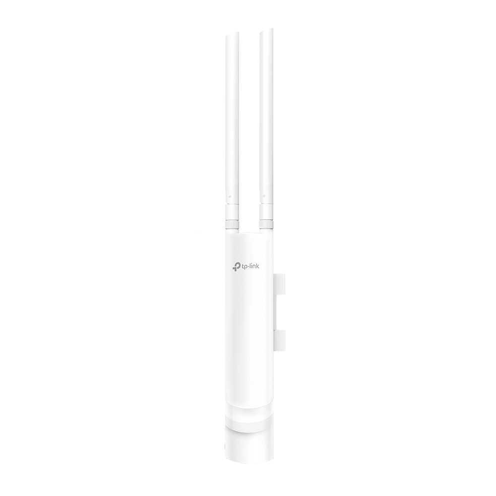

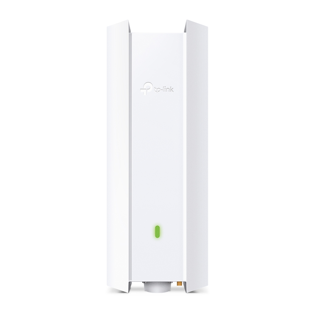

Maybe just a simple AP?
WiFi 4
WiFi 5
WiFi 6
It's best to check for yourself.
