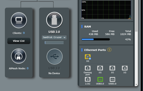

brand new run. but am getting this:
link speed directly to my laptop negotiates to 1000/1000 but router is 100/100

Plugging into one of the lan ports shows green and full connection. No dust etc in the port. I'll try to go directly into the ONT later with a short patch cable. But all the cabling in house was run fresh this am. I can get a cable tester from work on Mon, but suspect the router port.

Plugging into lan ports 1-4 show 1g connection and wan or 2.5gbe ports only 100mb connection.
I also plugged into my old isp router/modem with the same results so I am thinking maybe my router wan and 2.5gb ports are bad? Is there another way to test?

Yeah, link is only 100/100 from other pc's to the WAN and 2.5gb port.
